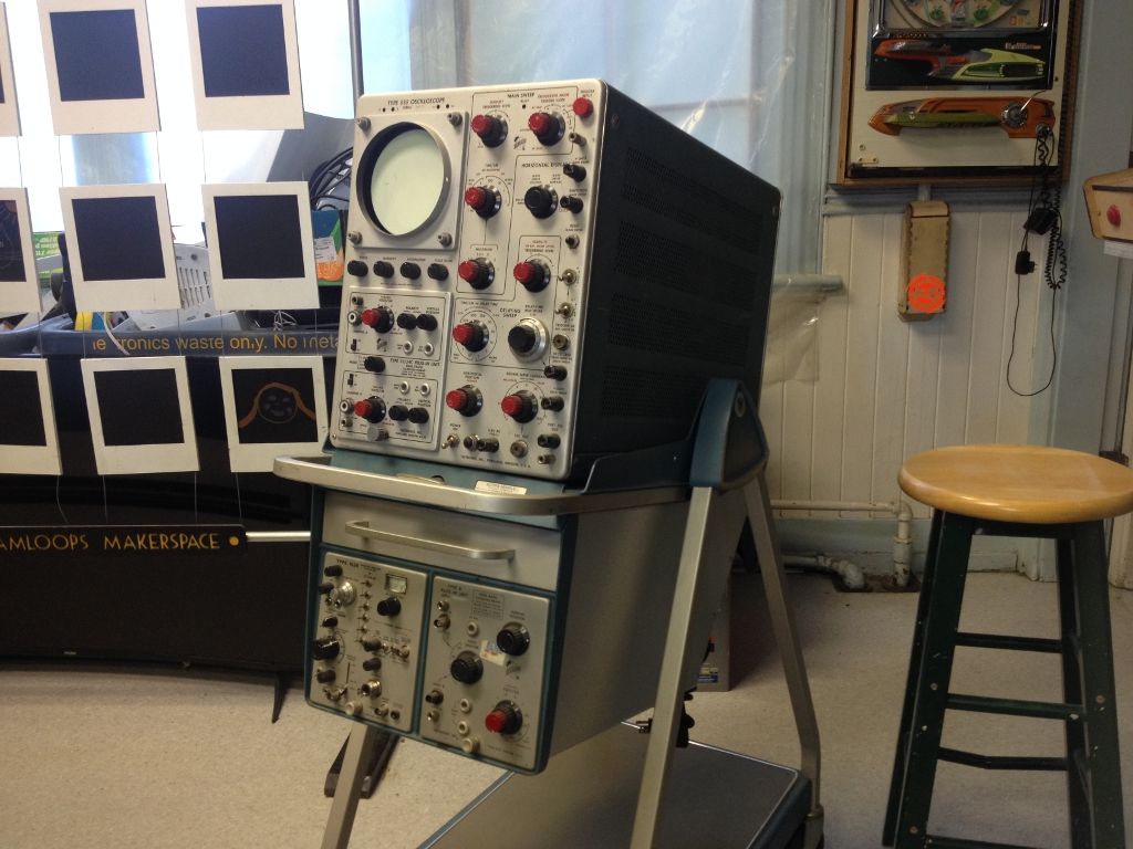

I recently came into ownership of a Tektronix 535 oscilloscope and a few neat plugins however that I can tell it has not seen use for a number of decades.
I have it somewhat dismantled right now as I do some repairs and inspect the stacked capacitors but I'm trying to figure out how to wake the chassis up. Under normal circumstances there is a delay relay that lets the tubes light and voltages stabilize before bringing the rest of the chassis up. I am not sure if I can safely variac the system in this state. Does anyone have suggestions?

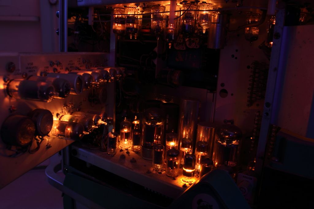

Update: Yeah it came up alright. Had to oil the fan and reseat a few tubes but no smoke and no bad noises. Just a gassy 12AU7A.

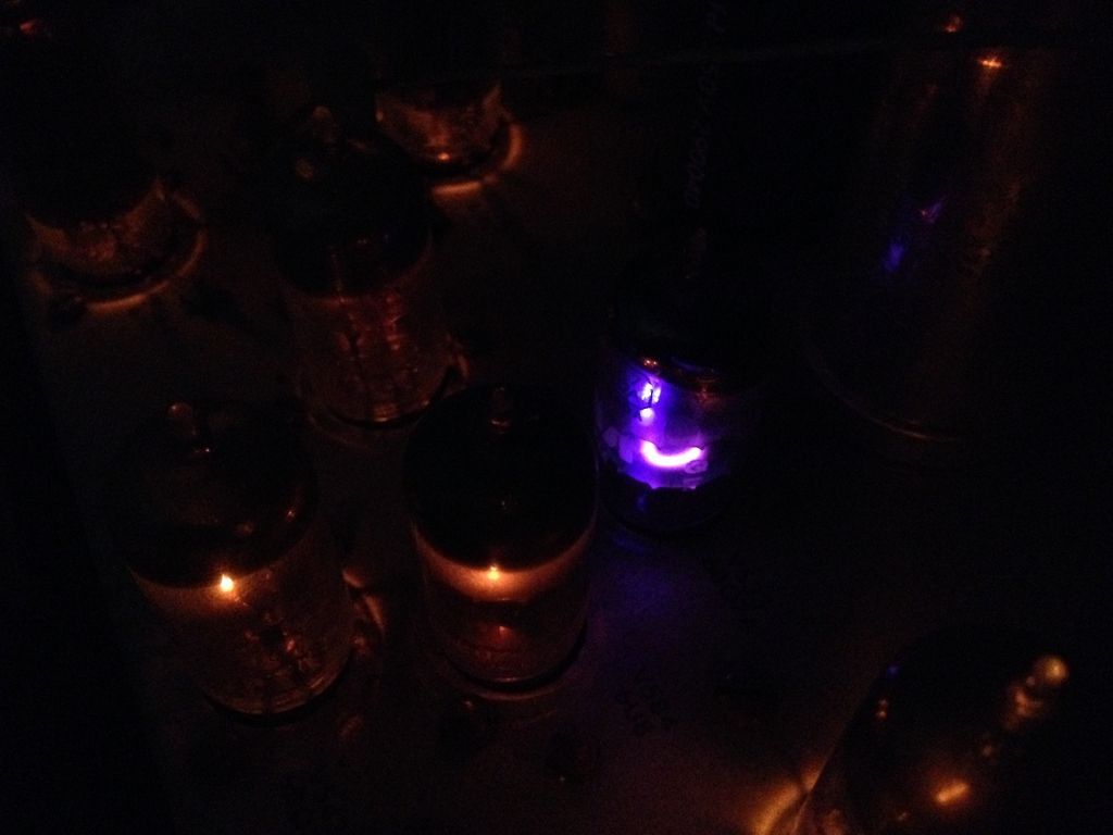

Okay hella bump time but my shipment of replacement 6BQ7A's and another 6AU5 arrived so now we have a scope fully loaded down with what should all be good tubes.
Still no trace.
With all the tubes in place and lit as soon as the delay closes I get a beam flash in the upper left of the display and then the beam finder arrows say there's something tracking left to right (the speed of which changes relative to but not exactly with horizontal sweep time) and even when I vertically center the control I don't see anything. Yes I can see neck glow.
The reason I got a spare 6AU5 was as soon as the delay closed the one in the high voltage section would light the glass a dull blue and after five minutes or so you could see it starting to redplate. The replacement tube should be good but when swapped does the same thing.
