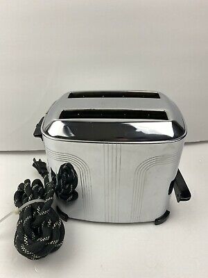

I just bought an antique 1920's toaster at an Antique store when driving home with my girlfriend, and the elements are still showing good at 22 ohms (550 watts which it says it is). I'm working on trying to find a power cord for it as it has those thick rods that stick out.
Question though, how exactly do I clean that clear material the element is wrapped around? Or should I not even attempt to clean it? I'm not sure what material it is, being this old, or even if it's really safe to try and eat from, but it does appear to still be functional.

You mean the mica sheet? I would try to not disturb it as it can be quite fragile. It's not harmful like asbestos though. Toasters still use it as a support material for heating elements because it can handle the extreme heat.
You are pretty brave to use one of those old manual one-sided toasters (if that's what you got). It's about as close to just tasting over an open fire as you can get.

Can you post some pictures? I've never seen a toaster from the 1920's.

https://imgur.com/a/7RJl3Xh

Wow, I sure wasn't picturing that. Thanks for sharing.

I was going to ground the chassis, also it's going in the kitchen which here every plug is on a GFCI. I can also add a thermal fuse if required.

There's nothing inherently dangerous about the toaster. Just make a firm habit of never leaving it unattended. Which, technically is the case for any toaster, even space heaters, hair driers, etc, etc. That, and take the usual precautions. ie, don't make toast while in the bathtub, don't operate it under your curtains, don't touch hot things with your hands, etc. I don't see a reason to add a thermal fuse, as it's very likely it would just pop after a couple slices of toast. Remember the thing is metal, and it will all get quite warm. Grounding it... I wouldn't. That's just me though, I don't mind the shock risk (it's minimal anyway). What I would do is a good inspection of the internal wiring, as old wires like to crumble. If you ask me, throwing a ground on it is not a substitute for actually making sure it's safe to operate. And once it's safe, then a ground is not really needed.
The mica sheet is probably not dirty at all, that's just how it looks. Or, if it is dirty, the dirt would be vaporized off of it after being heated for some time. Leave it alone.
There are plenty of replacement toaster cords (sometimes called 'heater cord' or 'appliance cord') available on ebay. Some old, some new-ish. Shouldn't be any problem with one of those. The pin spacing and size looks standard.
Incidentally, it being named the 'Flipflop' I think this is the type that flips the bread over when you open the door, so you don't have to touch the bread to flip it to toast the other side.
