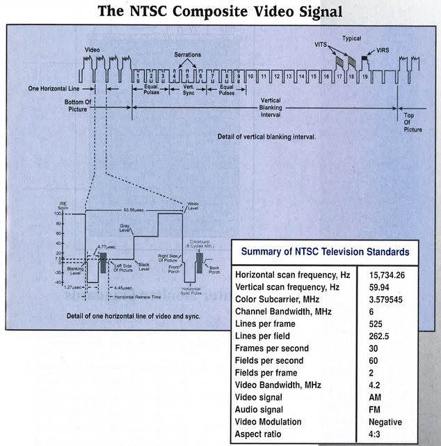

How to read VCR signal layout

Moving on to VTR, I have a question of how to read the signal graph of a typical "color-under" VTR:
Does it describe a whole frame/field, or a single pixel? From what I've read, brightness of a pixel is not described with amplitude, but rather with frequency, so the range from luminance tip (black) and white frequency describe brightness range. So, a range between, say, 3.5 MHz and 4.5 MHz, which is 1 MHz, describes the whole range of brightness... for a single pixel? For a pair of pixels? What is luminance sideband is for in this case?
On another hand, I read about, say, VHS, that it has deviation of 1 MHz, but luma range of 3 MHz. Ok, what does it tell me? In other place I read that for analog television resolution can be calculated as roughly 80 LWPH per 1 MHz, so 3 MHz means 240 lines, it adds up. But how exactly to read this information on the graph? If I divide 1,000,000/480/30 = 70, which is close to 80. Is it where this number comes from? But in this case this means that bandwidth describes one scanline. So, the graph can be considered a "photo" of one scanline sweep, where sweeping from left edge of the screen to the right corresponds to frequencies from the left edge of the luminance band to the right? Is this correct? But in this case how do describe brightness for all of these pixels, if brightness is described as frequency in the 3.5 to 4.5 region, so I can have only one frequency there for every moment it time? I am lost here. If someone can explain it in layman terms, I would be very grateful!

You need to learn the difference between an electrical signal vs time and its spectrum of frequencies.
If you look at a video signal with an oscilloscope, you can pick out the time sequence of frames, fields, lines, and the particular spot on the screen left to right.
The diagrams you posted are frequency spectra, and represent a long term average of the different frequencies in the signals. In general, a lower frequency (towards the left) represents a coarse repeating pattern of lines or dots in the picture, and higher frequencies represent finer patterns. When such a signal is modulated on a carrier, it generates new frequencies spaced up and down from the carrier frequency.

The diagrams you posted show the range of frequencies which MAY be present. What energy is actually in those bands depends on the picture content.
First diagram:
In the narrow band FM of the luminance signal, the slowly varying parts of the baseband signal produce the range of frequencies from 3.5 to 4.5 MHz, as you stated. But modulation by higher frequencies (fine detail) produces the luminance sidebands shown. You really need college-level math (Bessel functions) to determine what these are. If the system does not pass these sidebands, the fine detail will be filtered out.
