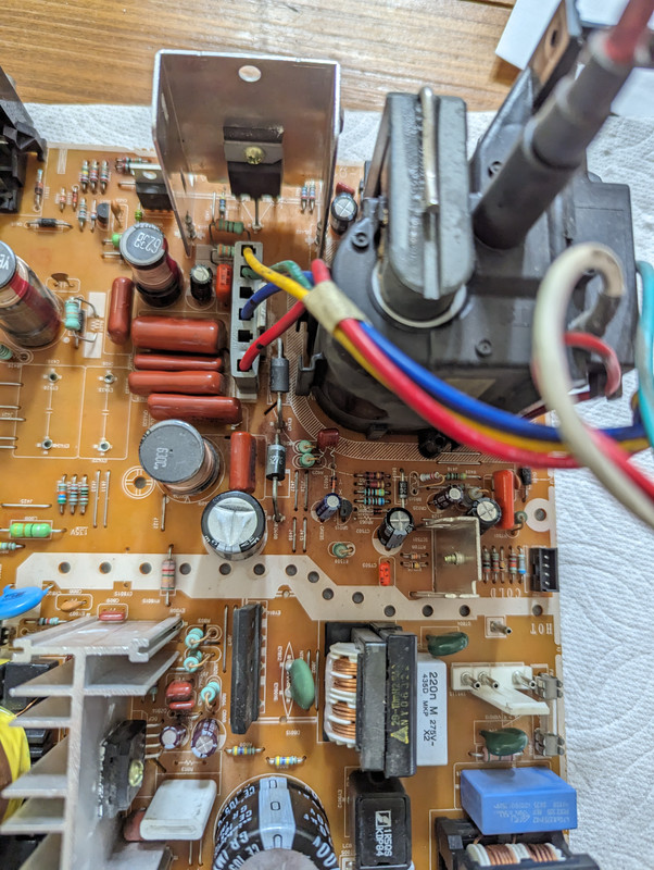

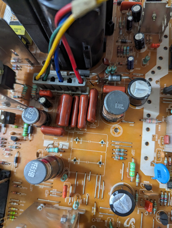

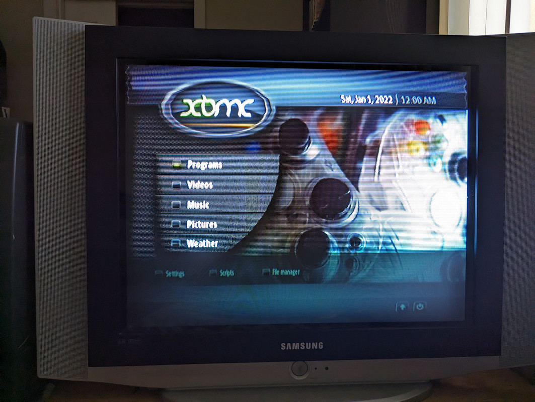

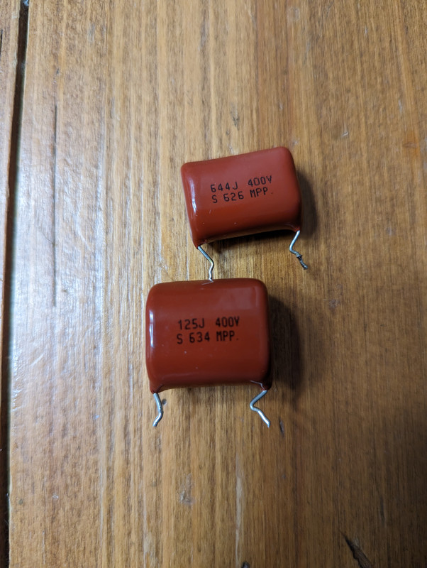

Okay. So I noticed that there is wiggliness in the top 1/4th or 1/5th of the screen. It relaxes and gets less wiggly when things warm up. From my research, that's horizontal deflection. So I recapped all the electrolytics. Pretty much any CRT is due for that. The colors and geometry got WAY better afterwards. Not bad for my first CRT recap. But even though everything looks better, the GOD DAMN deflection issue is still there. So I said okay, maybe these big brown film capacitors adjacent to the flyback are on the Fritz. So I remove one. Can't tell what 125j is because I have no electronics knowledge, so I measure the capacitance with my multimeter. Comes out to 1.2uf. okay. About what I would expect from a film capacitor. So I move on to one labeled 644J 400V (the kind of voltage I would expect would have to do with something like deflection). The multimeter read 615 NANOFARADS... What the hell? 615 NANOFARADS!? That's a completely retarded measurement. It should be under 5uf. Is this a sign that the cap is bad? Should I pull others just to see what kind of measurements I get? The first one was fine... There are service manuals for some of these slimfits, but my model has not been posted. In the 30inch service manual i found, there were part replacement details. this is EXACTLY what I need to replace the film caps, but I still don't know if I'm tackling the right thing.
I don't know what I'm doing. I'm extremely overwhelmed. I'm glad the electrolytic recap worked and I didn't fail at that, but these big brown sawhorse film capacitors are ridiculous. I don't even know if it'll fix my deflection problem in the first place. PLEASE help!

You can see the wiggliness in the screen pic.

First check the main B+ that feeds the horz stage. Must be right on.
The PCB is probably marked. Typical 130 VDC.
Those caps rarely go bad. Markings are the value, last number is
zeros. Ex 623 is 62000 in mfd or pf. Caps around the hoz / HV are
critical & must be the same values & type or you may blow things.
Odds are its another 'lytic but check it for cold joints in horz and
main power supply.
good luck

615nF is a reasonable measurement...that's 0.615uF. A bit low, but well within the 20% (I assume) tolerance of the cap.

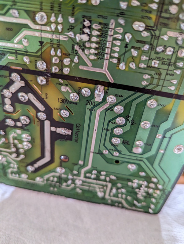

I will have to replace the film caps in order to test the B+ voltage. Is it safe to assume that the film caps are not the culprit? Should I just leave them alone? I don't even know how to convert microfarads to nanofarads.. I guess just 1 into 1000. Not a huge deal. But I can't even find replacements for these caps anyway. The 615nf measurement freaks me out. I can find .56uf 400v film caps on digikey, but that's it. Somebody here is saying it 62000uf. There's no way. Should I just leave these alone? I'm suspicious of the nearby transistor that's supposed to handle B+.
Zeno: Every single electrolytic capacitor was just replaced, so it can't be that. Soldering is sound. 130v is indeed marked on the underside of the board. So I should test it while plugged in? Where should I attach ground, chassis? If it's too high then a component has no continuity, and if it's low then it's basically shorting, correct? Also... Which contact is the 130? I can't quite pinpoint it... I guess I can just move around with the meter, until I'm sure I've found it. It can't be THAT far off...
The problem with my measurements is, I can't find replacements that match what I'm reading. The only way to get accurate replacements is by purchasing the service manual, the way I see it. But the film caps are probably fine. I believe my issue is elsewhere...
Should I give some of these solder points a good reflow?

130 VDC apx while set is on.
Caps are in mfd, or pf. Asian sets use nano at times. Also US uses mmf
at times, same as pf. Should be tons of sites explaining the conversions.
Its been 10 yrs since I opened a set so I dont want to give you bad info.
Before that it was 40 yrs of use & second nature. But age has
effected the memory !
Keep in mind this set has 2 grounds. Hot ground is the primary of the
power supply. The rest of the set is ( cold ) isolated. Use the CRT
ground or tuner shield for this one. There will be different ground symbols
in the manual.
