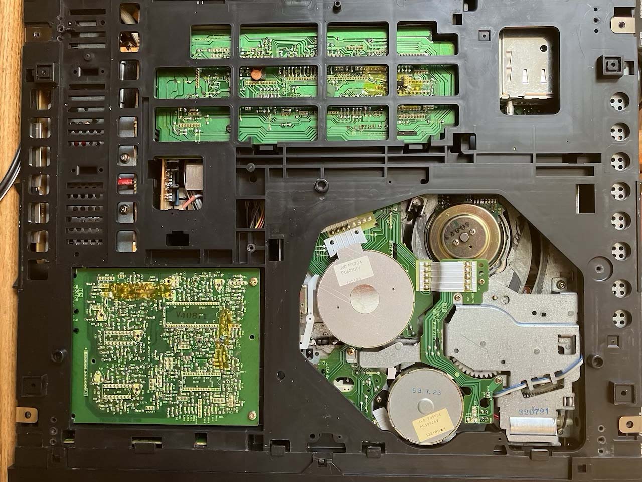

So, here's the back of the unit:
http://www.clickwidget.com/vcr/HRS8000U-back.jpg
And somewhere under here is the mode switch:
http://www.clickwidget.com/vcr/HRS80...haassembly.jpg
Even with the service manual, I couldn't figure out how to remove the mecha assembly. It doesn't tell you what screws to under, or in what order to disassemble things.
I removed all the screws and desoldered the board, but I couldn't figure out how to disengage it from whatever it was hung up on. I also have zero idea what the mode switch looks like.

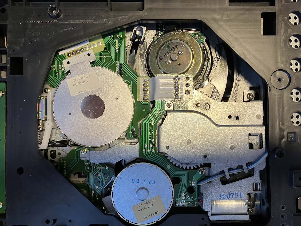

It gets hung up here:

Well, now I have to take it apart. The belt is slipping on the motor there in the lower right. I wonder if that was the reason all along.

The mode switch will look something like this..
https://kpcomponents.co/products/jvc...9444c846&_ss=r
I'm not saying that is the exact one for your model. Look at the SM for the part number. It may be called a slide switch.

Be careful if you remove that bottom plate to change the belt. Things must be kept in time. There should be information in the service manual.
Old 10-07-2024, 11:26 AM
olePigeon olePigeon is offline
Join Date: Oct 2024
Posts: 45
I've run into the problem that I can't get any further than I have. As mentioned above, it's stuck around something. I was able to determine it's stuck around a pin that connects to an arm. And that arm is either riveted to the mech chassis or screwed in inaccessibly from the opposite side. As far as I can tell, it would require that I completely disassemble the entire chassis just to get access to the section I need to replace the belt and gain clean the mode switch.
Unless someone else has worked on this model and can point out a different approach, I just don't see how it's even possible. I don't want to take it apart further than I have because I don't have a scope that would almost certainly be required to realign everything.
