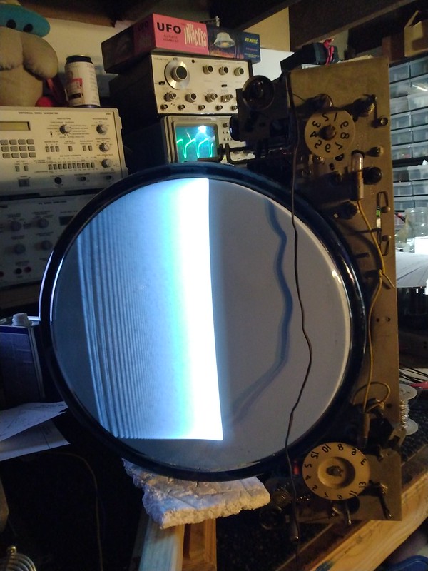

Time for a power up attempt.
OK, nothing. B+ is close to spec, but no HV and no sound.
Started by replacing a few caps on the horizontal oscillator. One had split open and one looked like a mica cap, but it's leaky paper inside.
That got the oscillator running and we have HV
Vertical is crunch though so went after that next.
Replaced a couple caps on the vertical output and that helped a lot.
Injected a signal next but cannot lock horizontal. Just not enough range on the freq or phase controls.
Replaced a couple caps on the 6AC7 AFC reactance tube.
All of these are paper caps and all are bad.
The one on the left was actually getting warm. Replacing that got a lock!
Not bad for just replacing a few caps and open power resistors.
