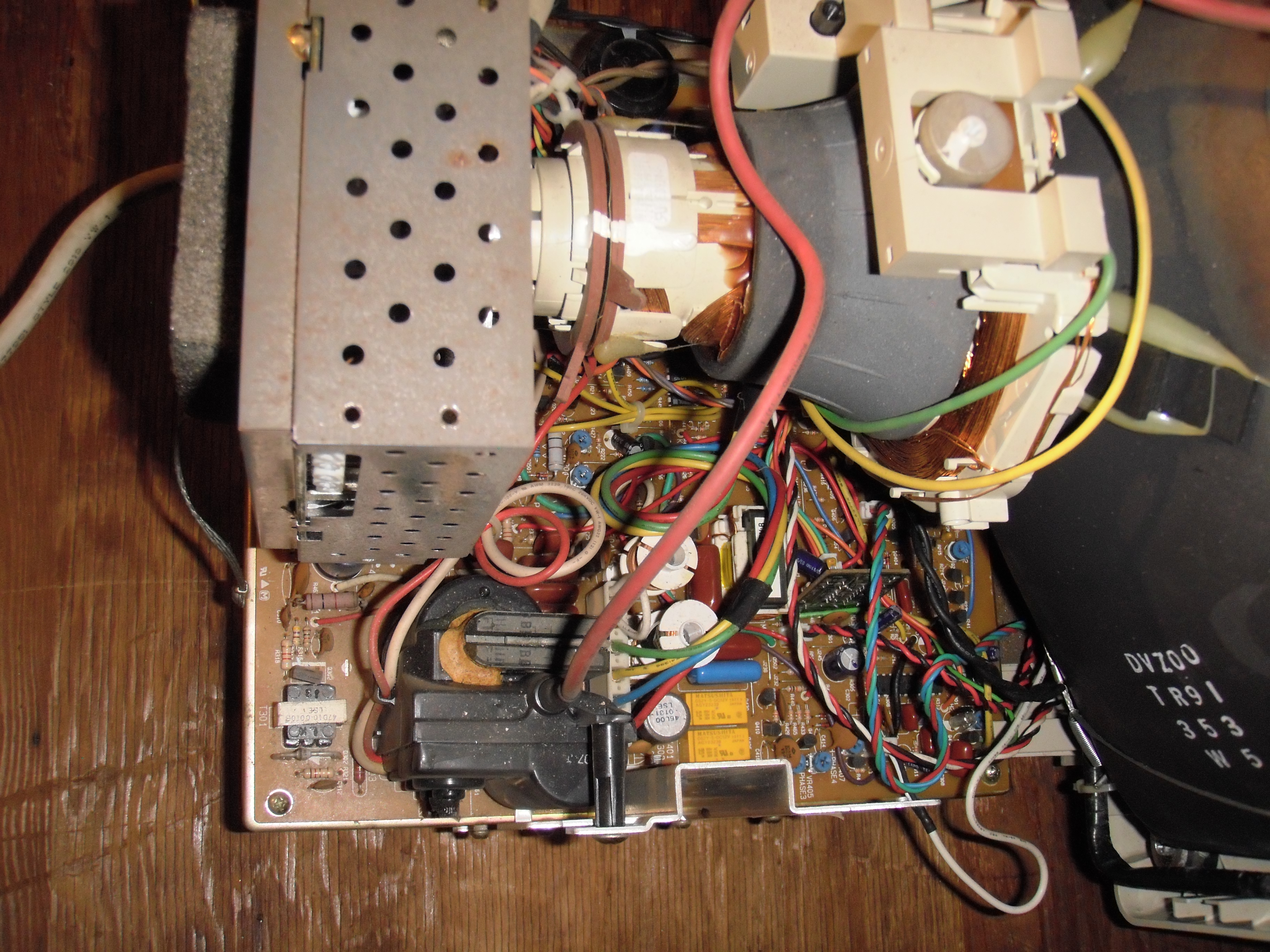

CTX CVP-5468NI picture increased width then shrank

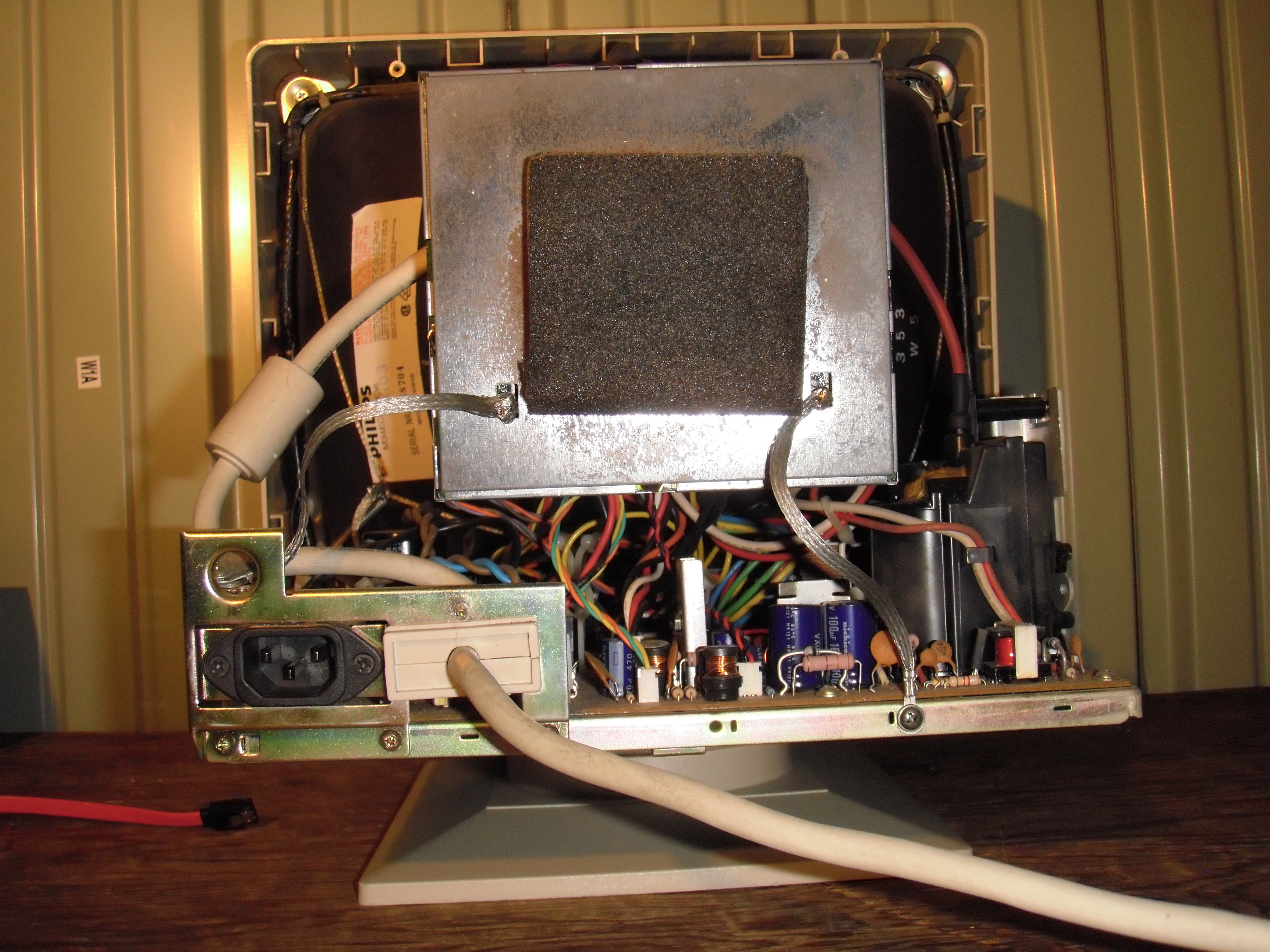

I've been making use of this VGA monitor with various computers since I got it in March, but its most recent application was as a monitor for my Linux box. That's when I started using the 1024x768 @ 60Hz (XGA) mode often.
Well, a few days ago I was in a white-on-black fullscreen terminal and suddenly the picture width increased drastically. I cranked up the vertical size. The horizontal geometry became distorted and the right edge was folding over. Then, I saw the picture shrink towards the center of the screen and I quickly hit the power button.
I turned the monitor back on a few hours later to be greeted with a dim, shrunken XGA image.
But, the picture is perfectly fine and bright in the 640x480 (VGA) and 800x600 (SVGA) modes.

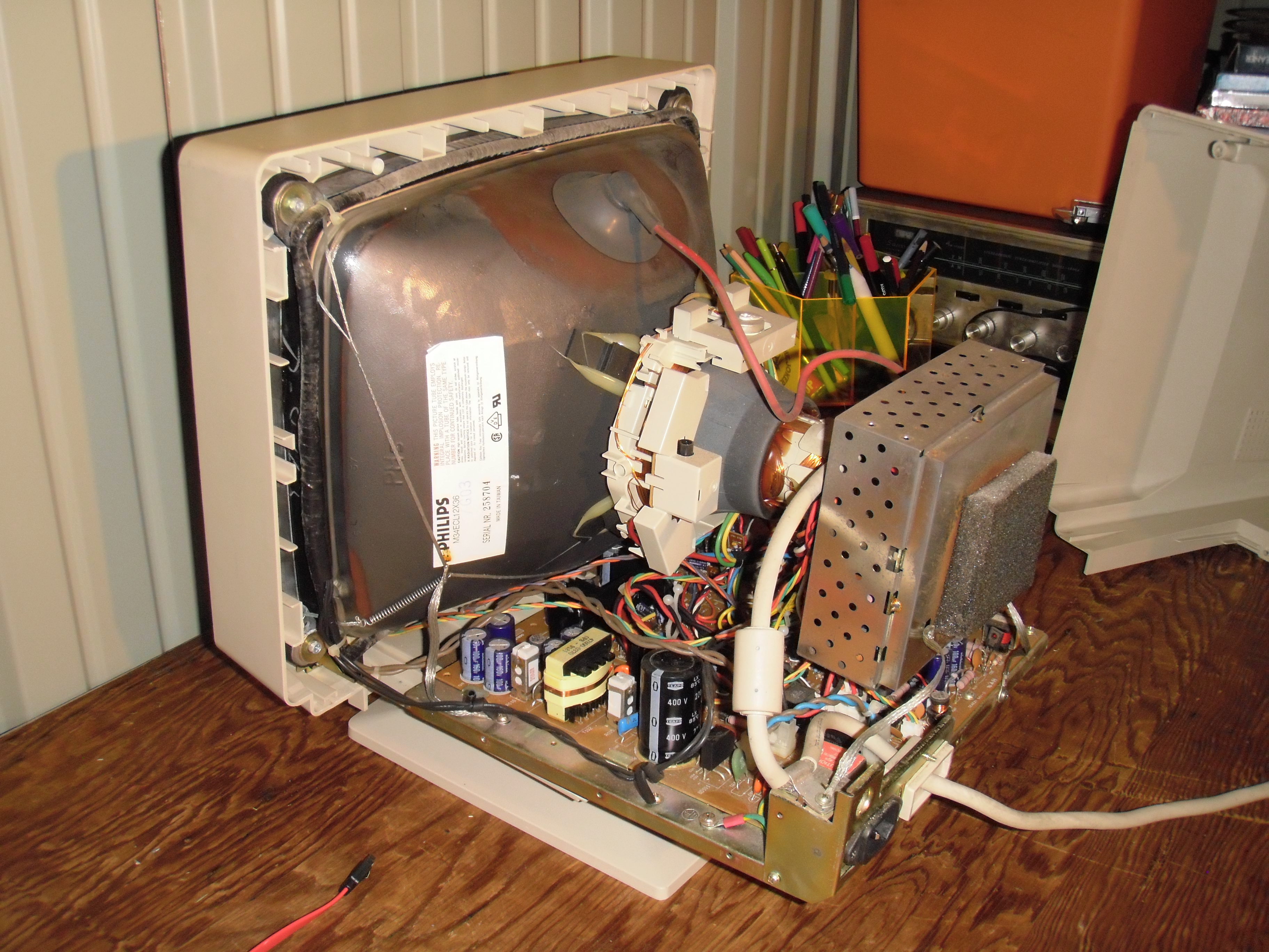

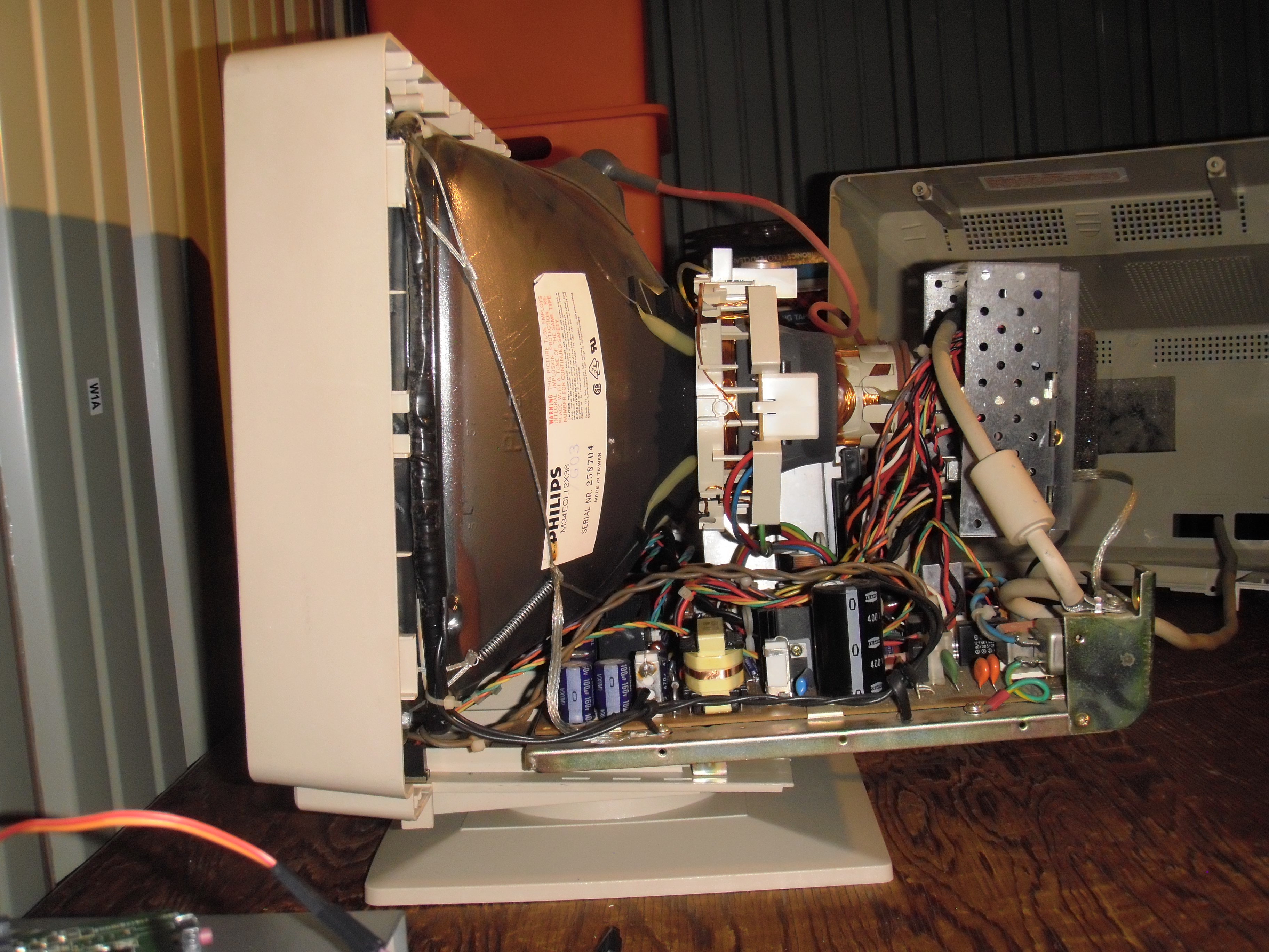

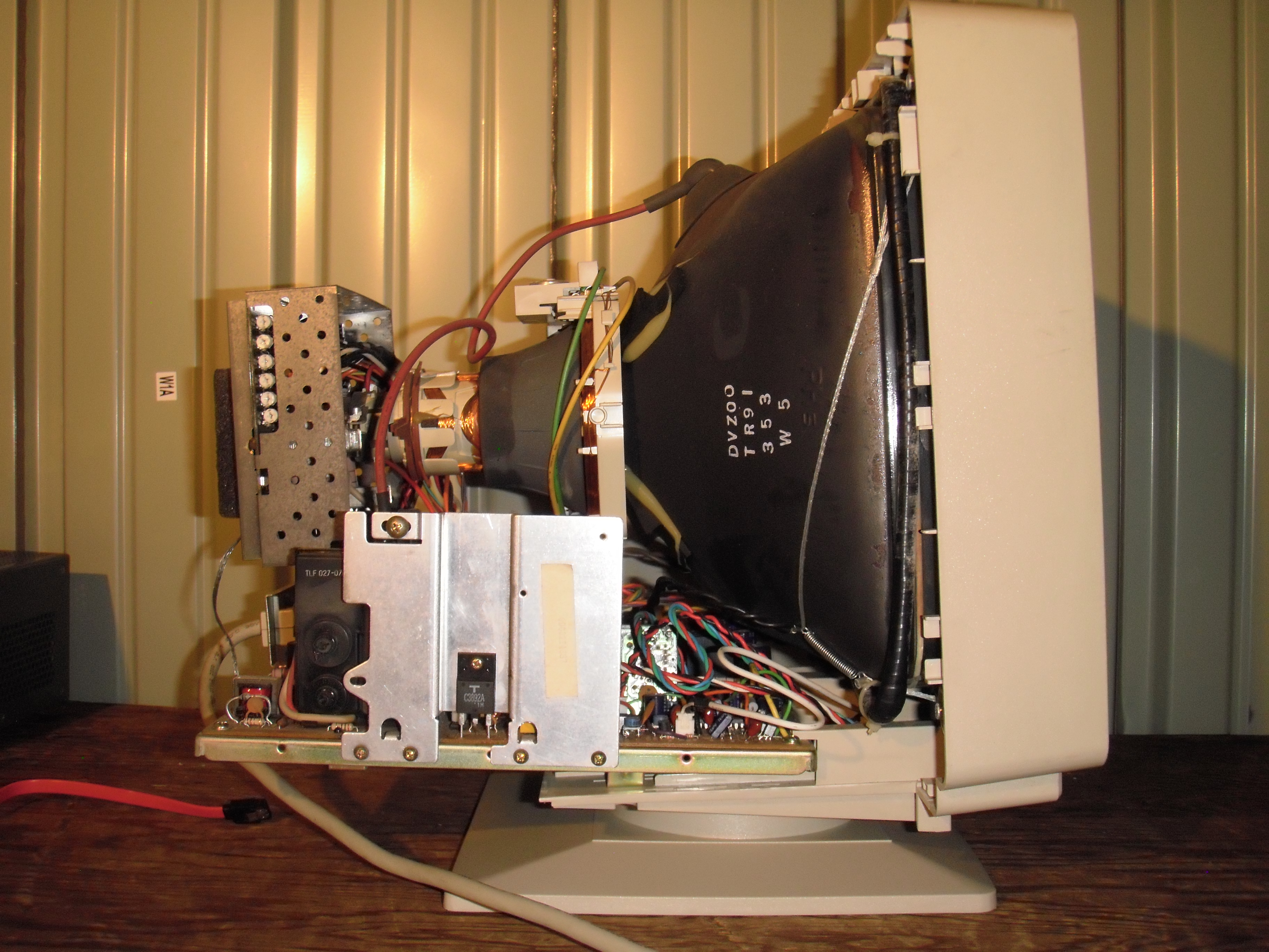

Here are some pictures of the monitor with the back shell removed. It's fairly clean inside, no visible signs of leaking caps or other damage.
https://files.catbox.moe/smj7cv.JPG

I'm inclined to think that a component in one of the horizontal circuits has failed and is bringing down HV or B+, after all XGA is the highest mode supported and therefore highest stress. I'll have to look over the example multisync SVGA monitor block diagram and see how these things really work (coming from CRT TV repair where the frequencies are fixed).
Any feedback would be appreciated. I really want XGA mode to work again on this monitor. It looked really good especially when driven by modern video cards which output very crisp VGA signals.

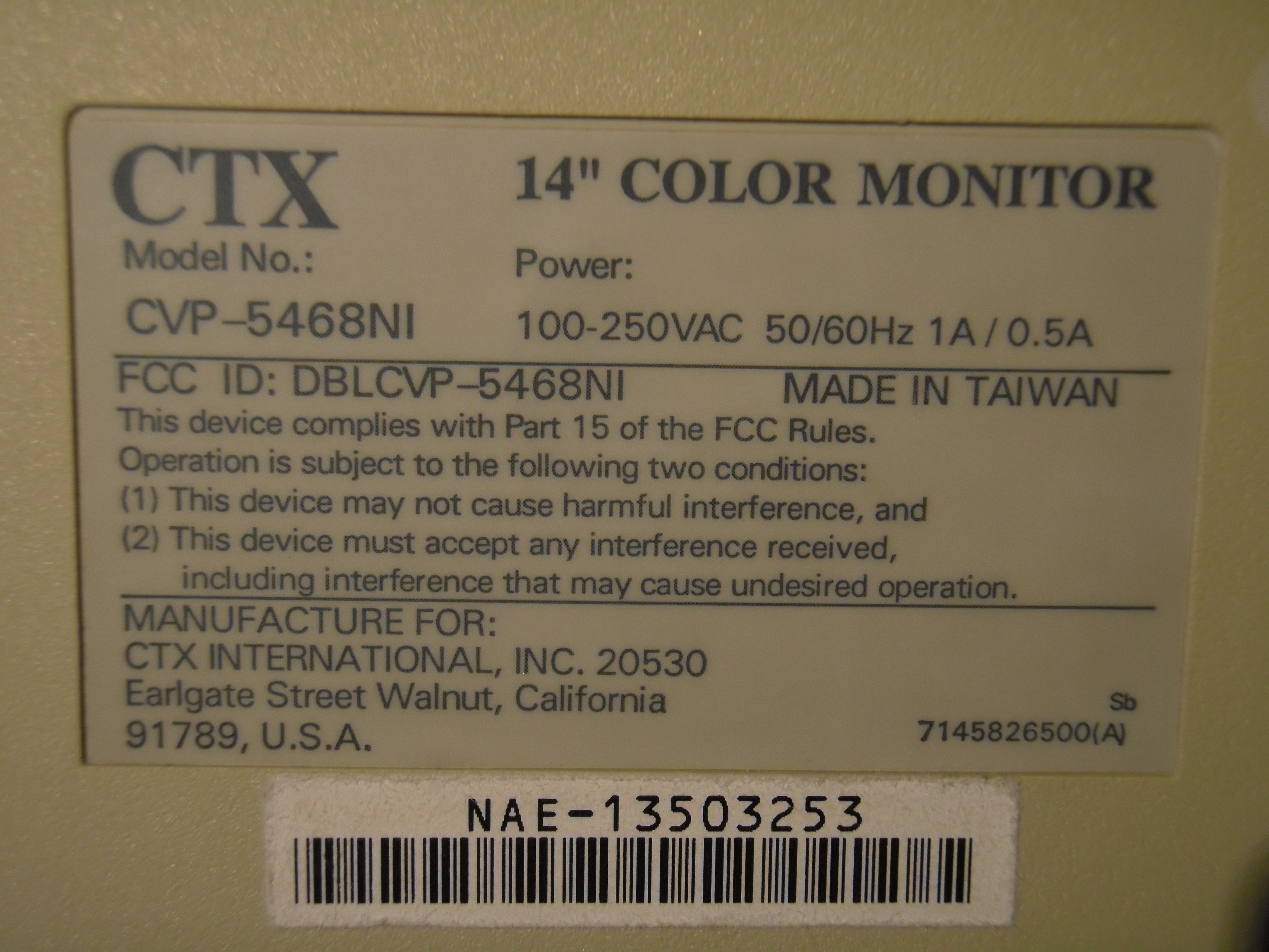

Looks like this monitor is what they say it is... The model number is the same under FCC filings.
https://fcc.report/FCC-ID/DBLCVP-5468NI
Would be nice to have the service manual

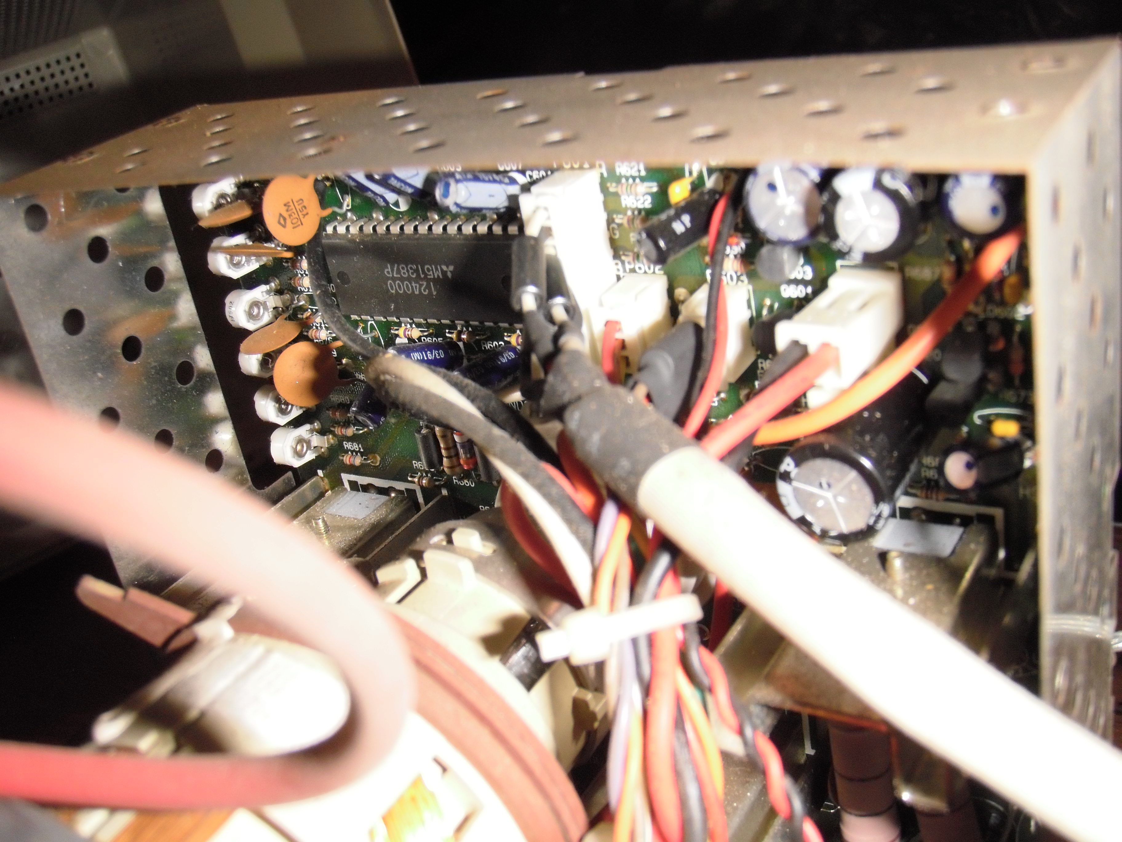

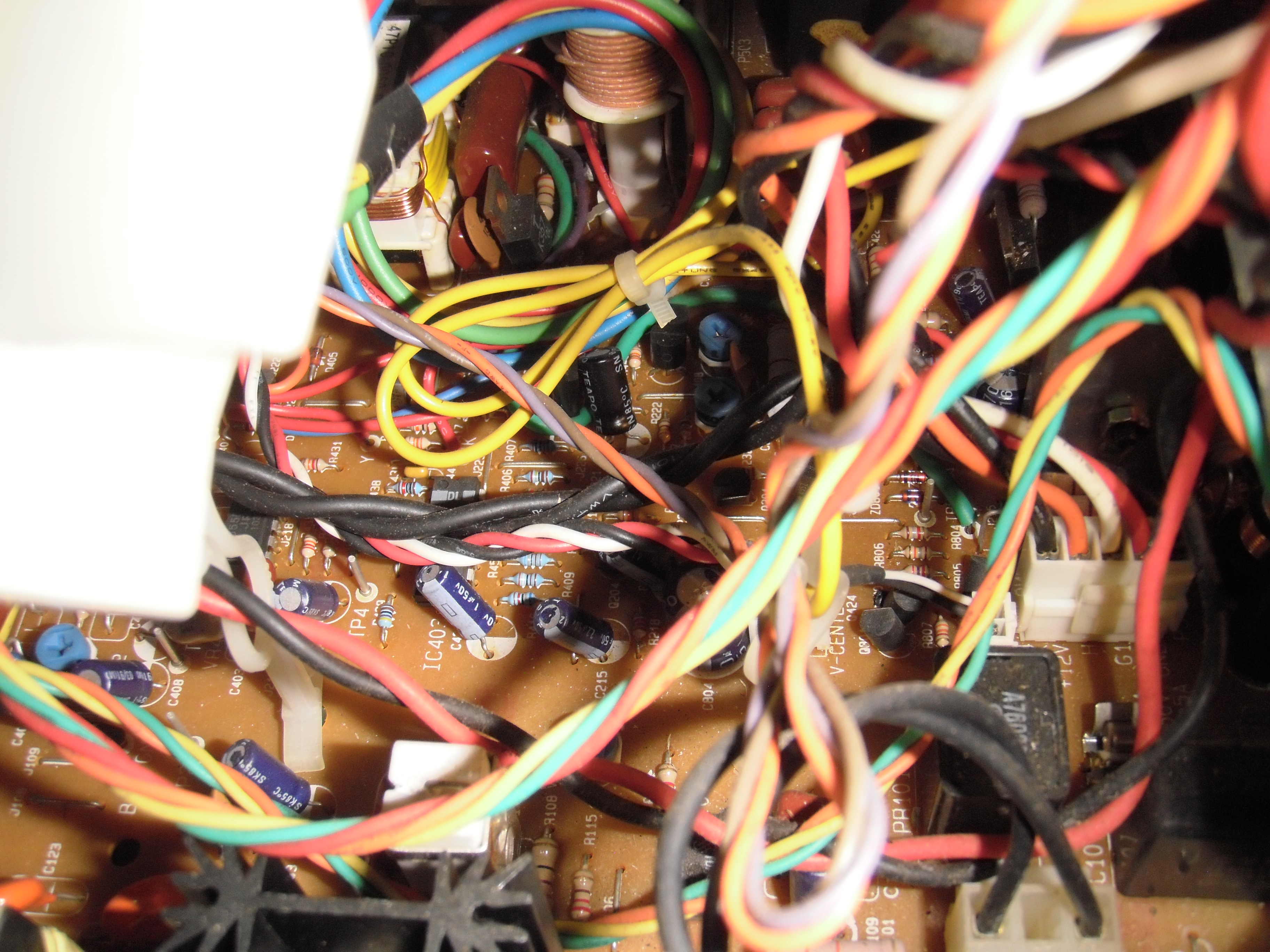

Good Evening; Good monitor, well worth keeping... The second picture you posted
https://files.catbox.moe/yo5ysk.JPG Looks like you have horiz linearity problem,
as listed on the site https://asavage.dyndns.org/Monitors/monitors.html like
you said search cvp-5468. I noticed that in a lot of the symptoms & solutions
area there are little reference to what mode the monitor is working in when
the problem is observed, so the mode selection may be the wrong spot to
go looking for an answer.... + Your screen pic seems to show a properly
synced picture, just poor linearity - So check on the part they suggest
5468 Hori linearity problem C322 .39J 400v. ESR should be less than 10.
At least that is where I would start with the information available.
The other thing I would do is step through all the items in the menu,
be sure every item works as it should, geometry, pincushion, etc.
Also it may just be worth looking at, but in this pic:
https://files.catbox.moe/a8oibs.JPG Not quite center of pic there is a
cap that in just above a twisted Orange, Yellow, & Green wires that
looks a little big on top - Look at it closer..... Also lots of the
problems & solutions on that page reference bad solder
joints - Like Zeno said, so make that a priority.
