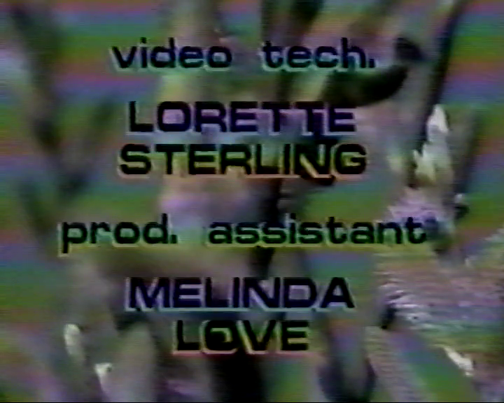

I bought one of those generic "ezcap" shaped USB dongles to get started on digitizing my tape collection. In my game of Russian roulette, I received a device that identifies as the following:
534d:0021 MacroSilicon MS210x Video Grabber [EasierCAP]
Linux kernel 2.6.26 and newer supports this device, so on my computer I can just plug it in and it works.
I currently use the following command to record video and audio from the terminal:
ffmpeg -i /dev/video0 -f alsa -i default -ac 1 out.mkv
I record the audio with my computer's built-in sound card, since the ADC on the dongle seems to have some weird DC offset issue. It's set as the default input in ALSA. The -ac 1 option tells ffmpeg that we are recording in mono, since I am archiving monaural Betamax tapes at this moment.
The problem is that this dongle is not very good at locking on to chroma from video tapes. It will work fine with video from my Hi8 camcorder, but so far not with many of my Betamax tapes.
Sample recording: https://youtu.be/Zh7PM-sGGn4
Will a video stabilizer fix it?
https://static.anarchivism.org/techt...zer/index.html
Or do I have to count my losses, return the dongle. and order a pizza instead?

Okay so seriously those USB dongles are at best for consumer use only and tempermental on a good day. What I suspect is happening is the burst level of the betamax is just below the threshold of the dongle DSP while your Hi8 has enough to lock on, you could grab the service manual for the betamax and find the burst level pot and push it up slightly or go with a more professional solution that being A. a timebase corrector or B a professional level capture device that is Linux compatible. On my end I run a number of TBC's as each seems to have a different "personality" with respect to the playback machine. For capture I use a Newtek Tricaster broadcast TC550 which does realtime capture but runs under embedded XP, I also have a Blackmagic PCIe SDI capture device for grabbing raw SDI right out of the digibeta deck. This captures everything raw right to disk, what I do is use the digibeta to transcode the analog input be it Y R-Y B-Y or composite plus audio to SDI or right off the betacam tape to fill a 2TB drive then slip that into my Linux box and edit/convert using Kdenlive. Even with a gigabit ethernet the transfers are painfully slow. The added advantage is the digibeta has proc amp level controls and doesn't need to genlock to the analog source however it is helpful. I realize this is a long trip around the park but it's so far been the best lossless solution that's affordable and compatible with the older 4:3 video without playing aspect ratio games.

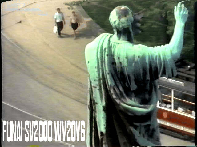

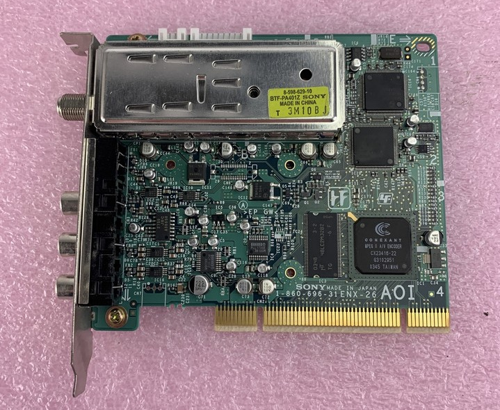

I bought a Sony capture card for $12 off fleabay, model no. BTF-PA401Z. It is supported by Linux under the ivtv driver and is reported as
"Sony VAIO Giga Pocket (ENX Kikyou) card (cx23416 based)"
This card provides an MPEG2 stream which can be captured just like this:
Code:
cat /dev/video0 >> recording.mpg
Uncompressed video is available at video32 but it's in a weird format that I haven't figured out how to record yet.
This card captures video with better color, clarity, and smoothness over the ezcap dongle, but it's more sensitive to horizontal sync than that or a real TV. On some tapes the picture wiggles horizontally (and that's what a TBC is for).
I made this GIF to show differences in picture between two VCR/DVD combos I tested.
So, to get a better picture on those imperfect tapes I'll either need to find a VCR with a built-in TBC or modify one of my VCRs to capture the FM signal from the tape head and do TBC in software with the vhs-decode project
