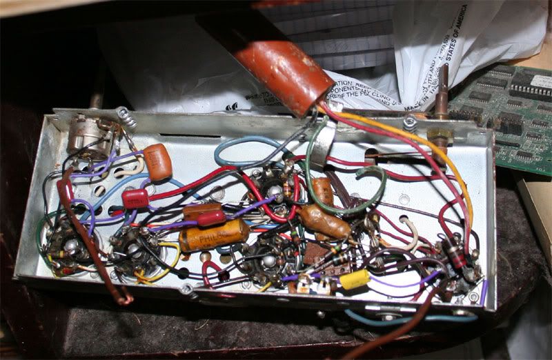

Posts: 435
Angry Frustration!
http://s28.photobucket.com/albums/c2...nt=badcaps.jpg (Little bastards)
http://i28.photobucket.com/albums/c2...ets/bottom.jpg (Status when I gave up)
http://i28.photobucket.com/albums/c2...ssets/cap1.jpg (Is this right?)
http://i28.photobucket.com/albums/c2...sets/caps3.jpg (More of my futile attempt)

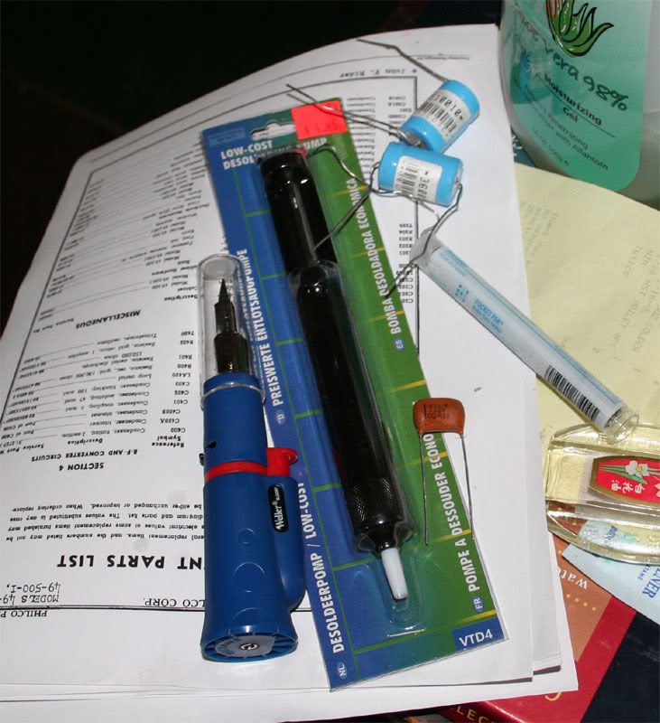

http://i28.photobucket.com/albums/c2...sets/stuff.jpg (The stuff i bought - BTW, how do I link those two blue ones together, to equal the big cardboard can?)
Above are the pics of the laughable soldering effort i undertook earlier. I didn't get to use the desoldering tool because the g-damned solder wouldn't even MELT. The cap values all match and the guy at the electronics store said that I would be able to use the caps I bought as long as the values were correct.
I got a Weller adjustable temp, butane-powered soldering gun because it said it got up to 900F, the guy said it was eqivalent to a 60-80w. Was I lied to? I think it's kind of neat.. I don't like the idea of drawing huge amounts of house current.
To be honest, this is the first time I've tried something like this... but it's incredibly frustrating when solder won't melt, and when it does, it balls up and turns into a puff of smoke.
Any ideas/tips on how to solder components like this? I left the other bad Philco cap in there because (along with eyestrain) I was fed up with the whole thing, i felt like a fraud for even attempting to do this. I said "what the hell" and gave it a smoke test. none of my new caps got hot, there wasn't any smoke or smell... or sound. but the tubes light up So it seems I installed the caps in the right "direction" but the problem may lie in the big cardboard can/remaining cap.

A 30-40 watt iron should be fine except for soldering to the chassis... but soldering takes practice, we all have to start somewhere! Is it lead-free solder? I hope not!
I wouldn't use a butane torch unless I had no other choice (like FAR from an outlet...) - too easy to burn something!

To replace old caps, we cut the leads right at the old cap, file them so they are clean, then bend the old cap end into a loop and the new cap end into a loop, then interlock and join the new lead to the old, crimping firmly with needlenose, then solder. Don't try desoldering the old leads from the tube sockets, it is too difficult and can cause damage. The splice and solder method makes very firm connetcions if the old leads are clean.
We have tried the butane irons and found they do not have much oomph at all. Would only use them as a last resort where electricity was not available.
This is not a torch like a Bernzomatic but a small pencil sized iron which has an internal butane flame and a standard soldering tip. A temperature controlled electric soldering station is the only thing we would consider using as it will adjust heat to solder anything from a terminal lug to a chassis all the way to a delicate surface mount component.
You can get one for around $75.00....we use a Solomon brand.

Ive been down the soldering with a weak gun route before and I can tell you if your gun isnt any good all the experiance in the world wont get the job done. Im a mechanic and do a lot of wiring harness repair and sometimes the wires im soldering are 10 guage, and without a beefy gun NOTHING will get that hot enough to wick solder into the connection. I bet once you get a better gun your life will be much easier.

That f-in green wire came off and now I have no idea where it goes. I'm about to go into the backyard and grab a sledgehammer.
What is the "accepted" method of wiring 2 smaller caps in parallel to create one larger one, besides the goddamn disaster I created, as pictured?
AND, are those acceptable needle nose pliers? I couldn't make a loop-de-loop worth a damn.... I feel like such a hack for even trying this.

There is a reproduction cardboard can electrolytic with new caps in it which will work much better as a replacement...I dont think those types of electrolytics you have got will fit in there, there is just not enough room.
You can get the replacement caps at http://www.tubesandmore.com
Click on "capacitors" and "multi and single section tubular electrolytics"
The site uses frames so there is no way to link right to the caps.
I think those needle nose are too big for this job...you need a type like an Xcelite which is made for electronic work.
