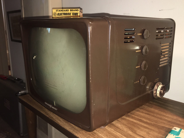

So, I nabbed a pretty sweet little GE 14T007.

What makes this set even more rare is the UHF tuner. You rarely saw them until they were made mandatory in the 1960s (unless you had a dominant UHF station in your market). This set is definitely worth restoring if no major component is dead.

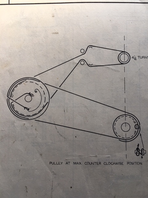

Yeah and the dial string is broke. You can see the broken end sticking up.

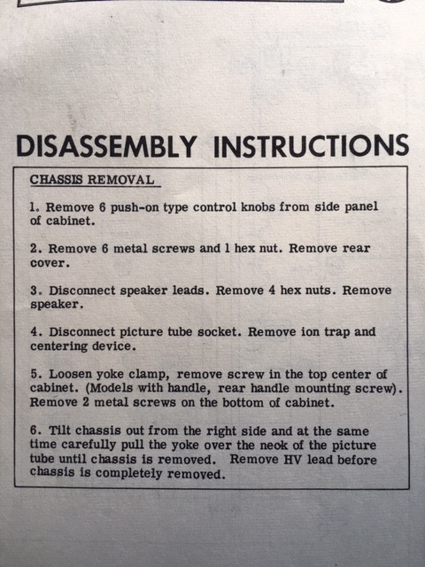

I don't remember if you can remove the chassis from the back on this one, or if you have to remove the CRT and go out the front, either way you should be able to have enough slack to reach in and remove the anode connector from the tube, just slip a grounded screwdriver under the cap to discharge it.
You have to slide the yoke off the CRT as you go so loosen the clamp and remove it first,

I'm no stranger to working on that set! It's kind of tricky to remove the chassis. You have to reach in from the right side to remove the second anode lead, after removing the yoke. You might have to remove the speaker too?

The one shown is the real cheapie model, no handle!
IDK if that's the early or late production? The early one uses a 5AN8 in the horiz AFC and audio IF, where the later one uses a 3AU6 and diodes for the AFC.

BTW, I've taken a picture of the removal procedure from the Sams in case anyone's interested. Step 6 seems the most tricky!
Someone mentioned the UHF tuner. Yes, it's pretty cool that it has that option, even though it seems like it's basically unusable these days (?) And, yes the UHF dial cord has broken off. Here's a pic of the dial cord diagram from the Sams...

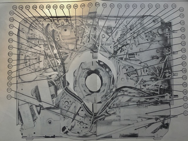

And here's the other side of the chassis, where the party's at. I'm pretty much all "Mousered Up" so I have what I need for a recap...Even a 1KV .015!
I had a Motorola that was similar, but was a lot better.
No handle is right! More classy that way!
Interesting info - Looks like late prod maybe - I'm seeing a 3AU6 for the audio IF.

I have done 3 of these sets. You have the early version. Chassis removal is a pain....I think I got the chassis half way out such that I could reach the HV connector on the CRT and discharged it with a probe. I have the Beitmans service manual (a reprint of GE service manual) for the late set and it reccomends crushing defective original caps and resistors on the PCBs and twisting the old and new component leads together and soldering....I have to agree with that approach....the solder side of the PCB is blocked by the chassis and unscrewing the boards to get at the solder side usually destroys the factory board standoff grounds and involves unsoldering several wires...
