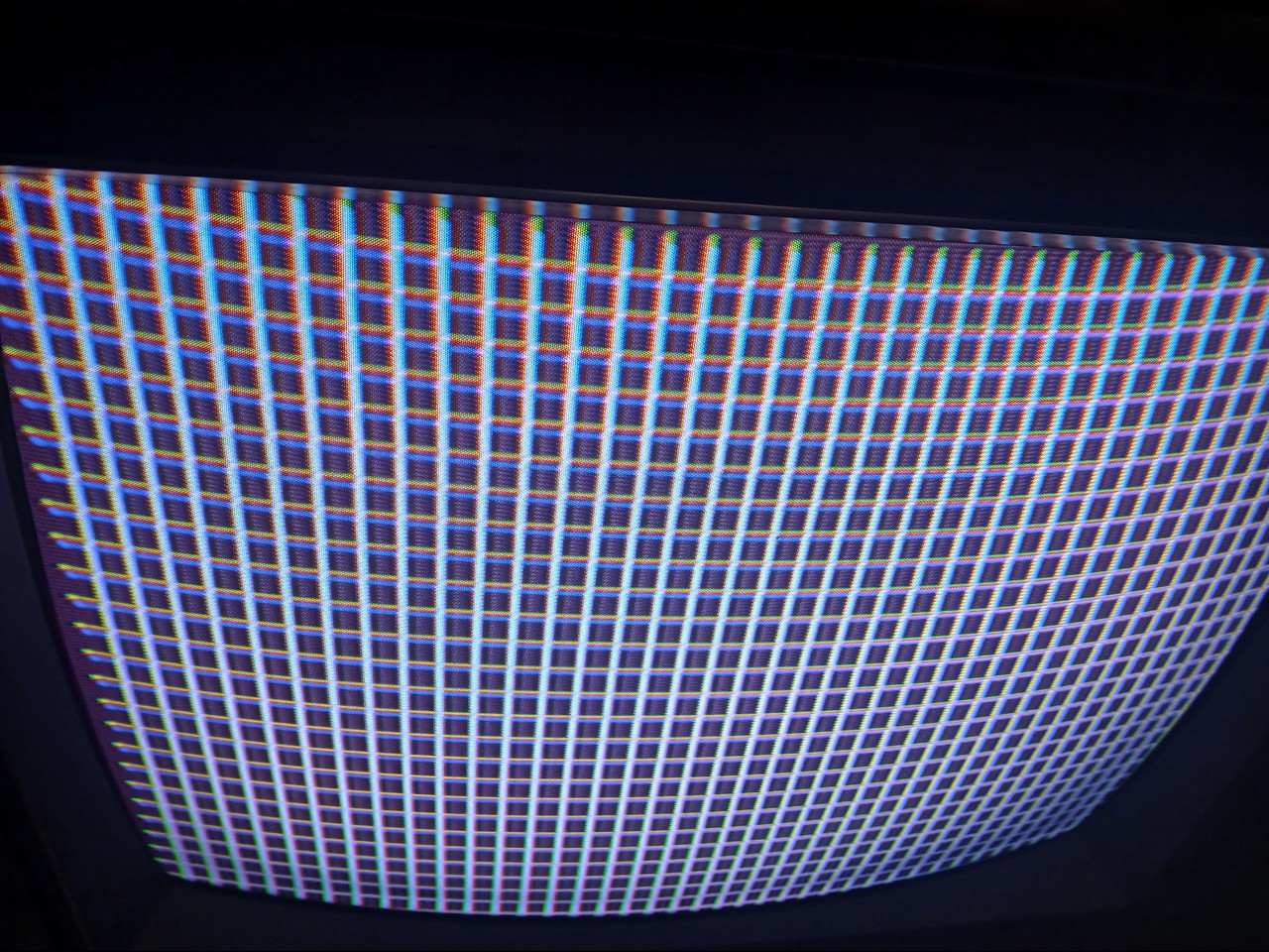

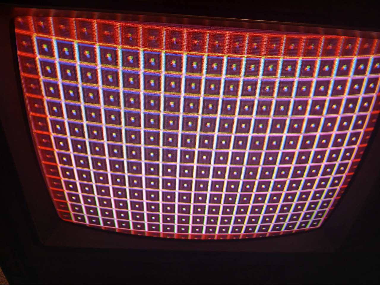

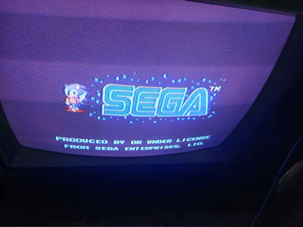

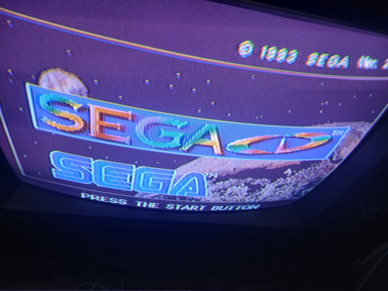

Ok, weird. Pulled board out and figured I'd put the old one in to see what happens. Had to set color and tint but here's what I got. Should I look at anything else before I close it up?

If it we me, I would pull and test every component on that little board, and replace anything that is out of spec (usually 20% for most components, maybe 10% for important resistors). The main concern I would have there is that the color board has an IC on it that could get stressed if some of the components have drifted too much, and that could be hard to find a replacement for it if it dies. 1970s ICs do not have a reputation for robust lifespan.
Also, your convergence is atrocious, so I would definitely dial that in with the yoke first. Caveat that yoke carries lethal voltages, so proceed at your own risk. Do whatever you have to do to learn how to handle it before you do anything.

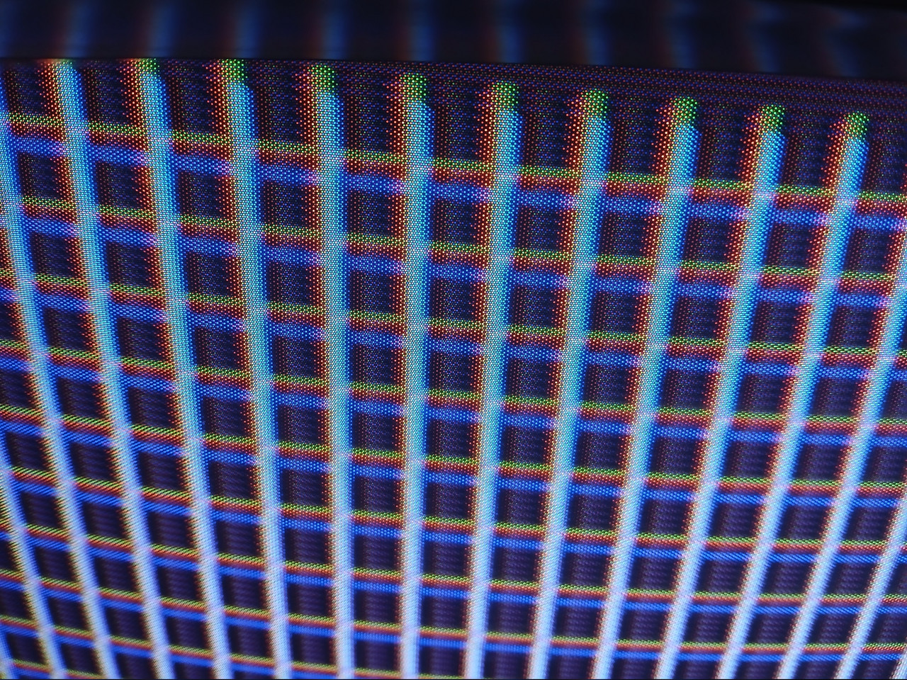

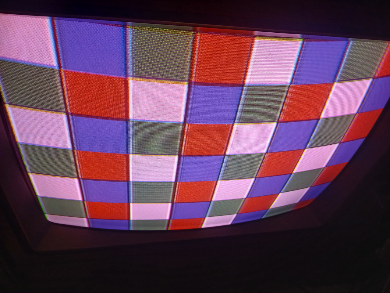

Explanation of the ring below, but first, I think you should check the yoke for slippage. Looking closely at your screenshots, I think the yoke probably slipped, and it's pointing up too much. You can see in your grid that the image gets bigger towards the top. I think it would be fixed if you pointed the yoke down and glued it in place. You can imagine the effect of moving the position of the yoke in the same way that pointing a projector at screen distorts the image if it's pointing up or down (or left or right). It's going to bow the image outward in the direction that the lens is pointed.
It can be very dangerous to move a yoke when the set is on. Make sure you know how to be safe. Consider just doing it in small steps while it's turned off and then checking it. It will take longer, but you also probably don't have the correct safety equipment to do this while it's on.
The rings (maybe):
I've never done an RCA before, but rings can be for both purity and convergence.
Purity is the color uniformity across the entire screen that is effected by how far the yoke is pulled in or out from the base of the tube's neck.
If you can imagine, when you pull the yoke in and out in line with the neck, the whole image will get bigger and smaller. However, the relationship between the position of the yoke and the tube will effect the spot that the beams land on the inside face of the tube because you are changing the geometry of the beam landing when you adjust the yoke.
The purity rings basically allow you to dial in the beam landing by giving you some whole-screen adjustment for the purity. You generally adjust this by 1. setting the purity rings to dead center, 2. putting up the three color (R, G, B) stripe pattern on the screen, and then pulling the yoke in and out until the stripes are dead even, 3. putting up an all white image and adjusting the purity rings until the image is totally white on the sides.
The convergence can be set by rings, but it can also be set by a potentiometer. This is almost always found on a box attached to the flyback or tripler, or it's found on the neck board. I've personally never seen one anywhere else. When it's a potentiometer, it's just the horizontal convergence, and the remaining rings set the vertical.
So what I think your rings probably are is two for the purity and two for the vertical convergence, and there's probably a dial inside somewhere that does horizontal. But that's just a guess based on other sets I've done from the same time period. I've never worked on an RCA before, and sets in the 70s tended to be less similar in design than they became later on.
Again, I've never worked on an RCA before, but I would guess that the rear two of the four rings would be the vertical convergence, just from experience. The rings closest to the base of the neck are typically the purity rings, assuming it has them.
If you do end up messing with it, I would recommend picking up some thick electricians rubber gloves to move the rings. They are not foolproof, but they will at least keep you aware of your hands and what you are touching. I personally still use them. I also use an isolation transformer so that the TV is not directly connected to the power grid.

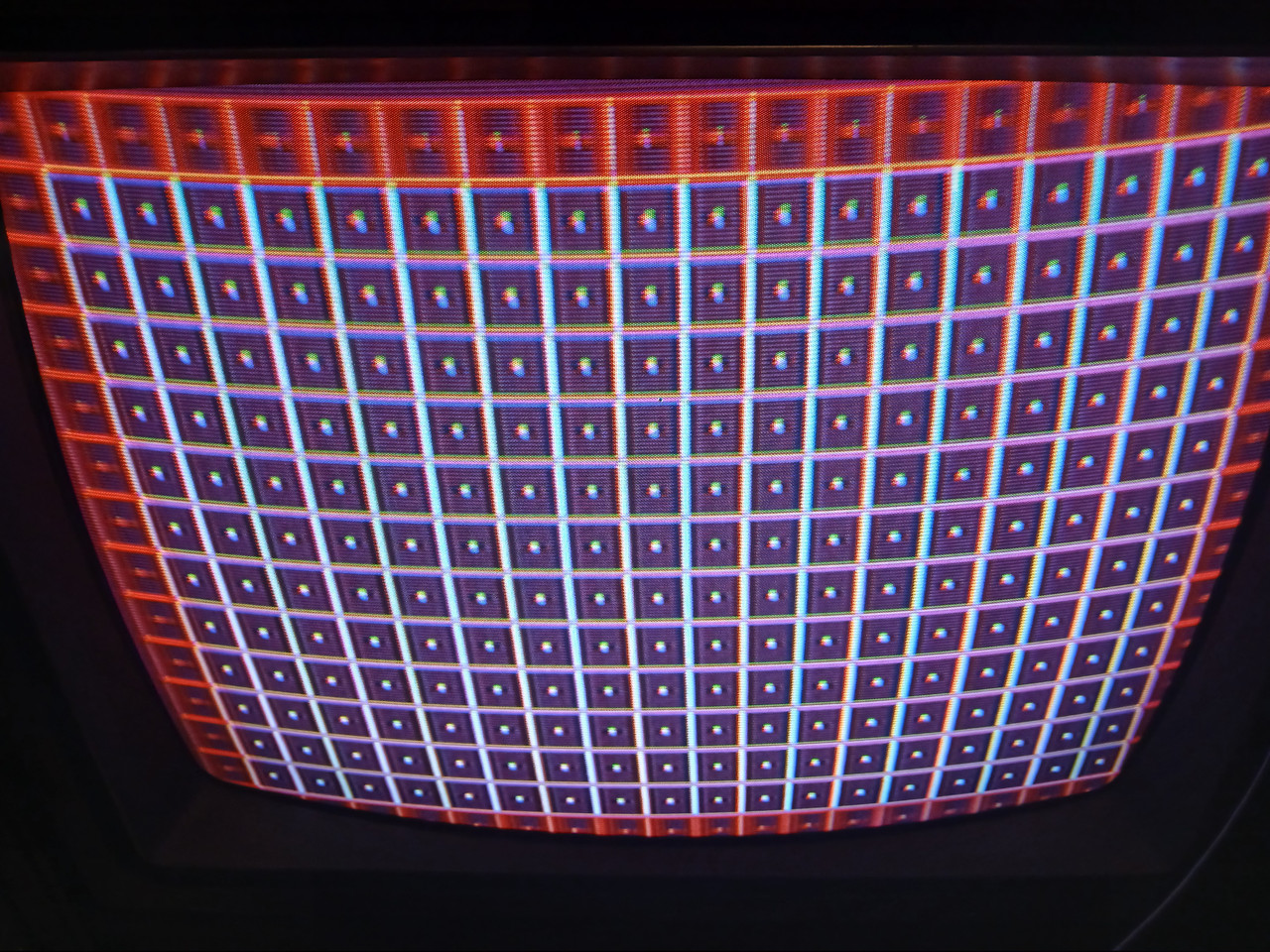

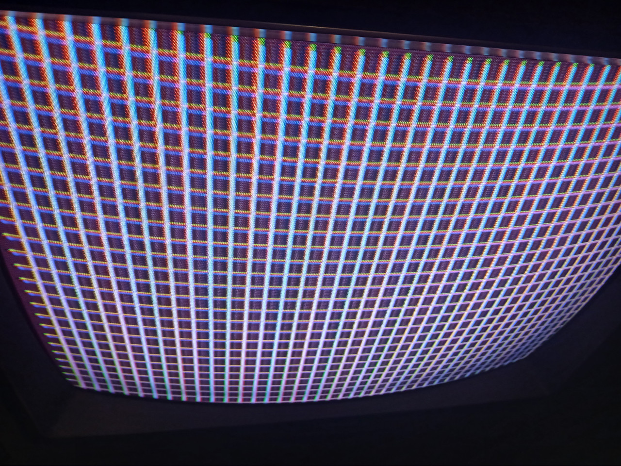

Now its tilting down like it was when I got it. I dont see any change really but maybe you can.

Not really, no. Tilting the yoke enough in any direction will have an effect though, it absolutely has to. If you moved it and you got nothing, then you didn't go far enough.

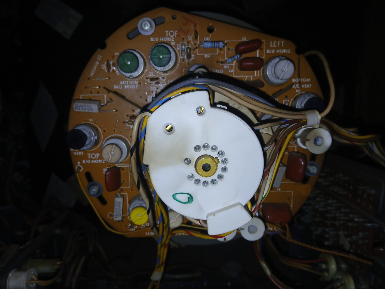

That sounds wrong. Something was probably messed with before you got there, and the extra color board inside suggests they gave up on it.
I would assume that your set is not supposed to adjust with yoke movement if you're not getting any change. I know there are such designs, but I've not worked on one before. Sorry, I'm not there in person, so I made an assumption that I shouldn't have.

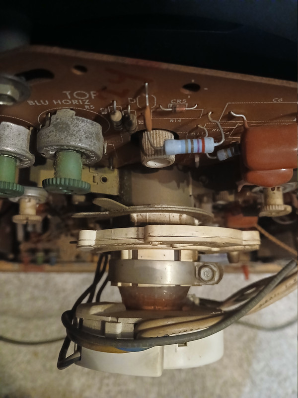

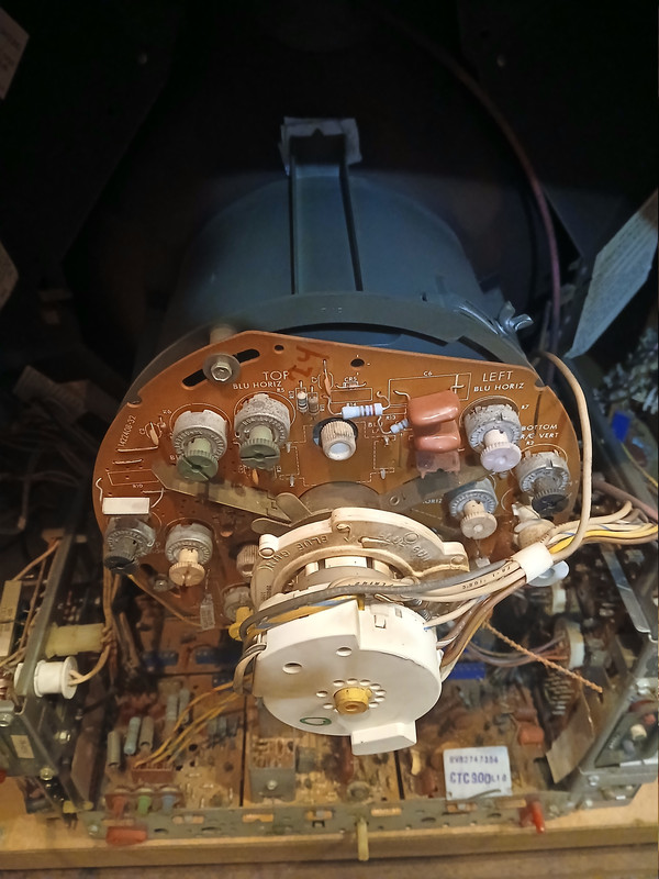

Looking at the pictures of your neck board, there appears to be knobs that relate to the convergence. I think that is where your solution lies. Do your best to document the effect of each knob before you go messing around with them. A good approach is to make a mark on the knob and the PCB so that you can return each one to it's starting position if necessary. Sometimes I will do that with tape so I can remove it when I'm satisfied.

Ok ill check these one at a time after I mark them.

Start with the 3 white shafts that protrude through the board at 12 o'clock, 4 o'clock, and 8 o'clock.
